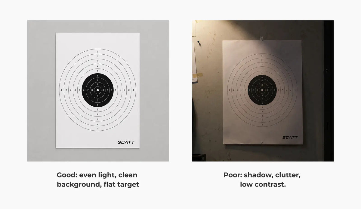

2. Use a clean, flat printed target
Make the target easy for the sensor to recognize.
Make sure that the paper target is flat against the wall/surface, not wrinkled or bent, and placed on a clean background;
Do not place the target on a dark, patterned, reflective, or cluttered background. Even if the target looks clear to your eye, poor contrast can make target recognition unreliable.
Well-lit SCATT paper target on a clean background compared with a shadowed target on a cluttered background
