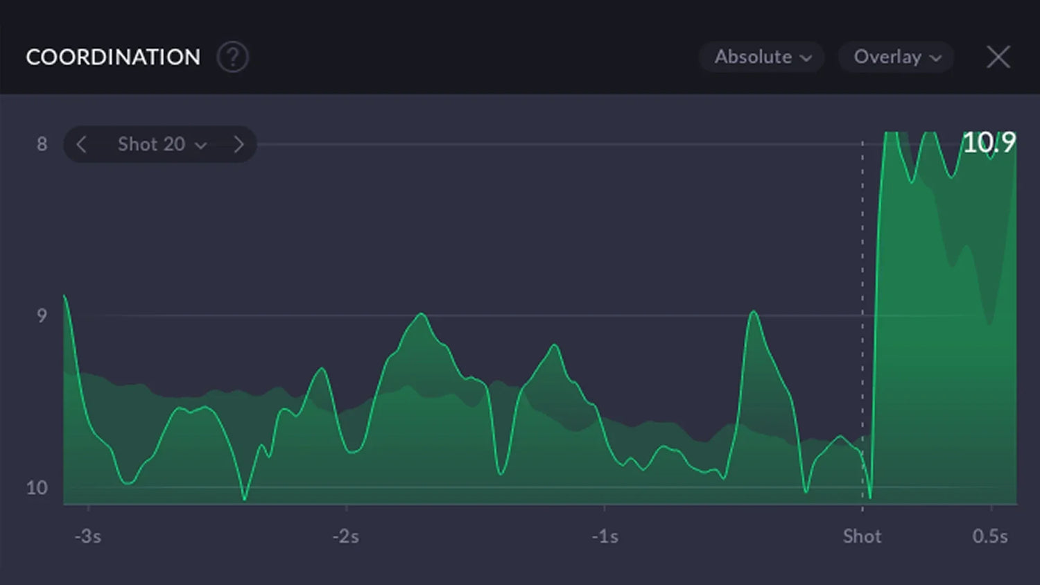

The Coordination Diagram helps shooters and coaches examine what happens during the final second before a shot. This article explains how the curve can indicate loss of weapon-position control and coordination issues around trigger release.
The «Coordination Diagram» shows the time equal to one second to the actual time during which a shot is made along the X axis, and deflection from the centre of the target along the Y axis, while the resulting curve shows the mean deflection of all the aiming trajectories from the centre of the target.
Analysis of the curve makes possible the evaluation of a shooter’s skill and readiness at a given time.
The curve may be of three different types as follows:
  1. Smoothly descending prior to actual shooting
  2. Horizontal
  3. Ascending prior to actual shooting
The first and the second types of curves are as a rule indicative of a shooter in good form and of a successful training session, although one should also pay attention to the deflection of the curve from the centre of the target. Beginners often produce smoothly descending or horizontal lines, though being rather far from the centre of the target, this is not indicative of high standards. The third type of curve- the one with a slight ascent- relates the existence of a problem during the final stage of shooting. In other words, the weapon is shown to deflect from the aiming point prior to shooting.
The beginning of the curve’s ascent almost always lies within the range of 0.3-0.2 seconds before the shot is executed. It is related to the time of a human’s physiological response. While aiming, and having made necessary adjustments, a shooter makes a decision and instructs his finger «to pull the trigger». The time delay between having made the decision and executing the shot is 0.2-0.3 seconds.
The same is observed on the target while undertaking the simplest analysis of an aiming trajectory.
In the following example the aiming trajectory 0.2 seconds prior to actual shooting is shown in blue, while the trajectory 1second prior to shooting is shown in yellow.
It is evident that a shooter holds the weapon rather firmly in line with the centre of the target during the 1 to 0.2 second time span prior to actual shooting, but that the weapon is deflected from the aiming point during the last 0.2 seconds.
This phenomenon may be called the Number One problem in shooting. In fact, it is encountered by every shooter- from a beginner to an Olympic champion. When asked, a sportsman answers that either his finger fails to pull the trigger, or that the trigger is too hard to pull. Another common response is that the stability is good, but that at the point of shooting the weapon deflects from the centre. The main cause of the problem lies in the loss of control over the weapon’s position.
