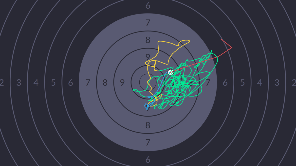

When a shot is recorded using a SCATT shooting trainer, the colored line visible on the target is the aiming trace. It shows how the aiming point moved in relation to the target before and immediately after the shot. At first glance, the display can look complicated, especially when several colors overlap in a small area. The colors are not separate scores or independent measurements. They identify consecutive time intervals within the same aiming movement.

SCATT interface displaying the complete aiming trace on the target
Reading the aiming trace in the interface
SCATT displays the movement of the aiming point relative to the target. After the shot, replay the trace to see how movement developed over time rather than judging the final shot position alone. Begin with the complete trace and notice the movement into and within the holding area. Then follow the colors in sequence. This gives each interval context and prevents a common mistake: focusing on one unusual-looking part of the line without understanding what happened immediately before or after it.
Read the sequence from green through yellow and blue to red. Green covers the recorded movement before the final second. Yellow begins 1.00 second before the shot and continues until 0.25 seconds before it. Blue covers the final 0.25 seconds before the shot. Red records follow-through after the shot. Yellow and blue together make up the final 1 second before the shot.
