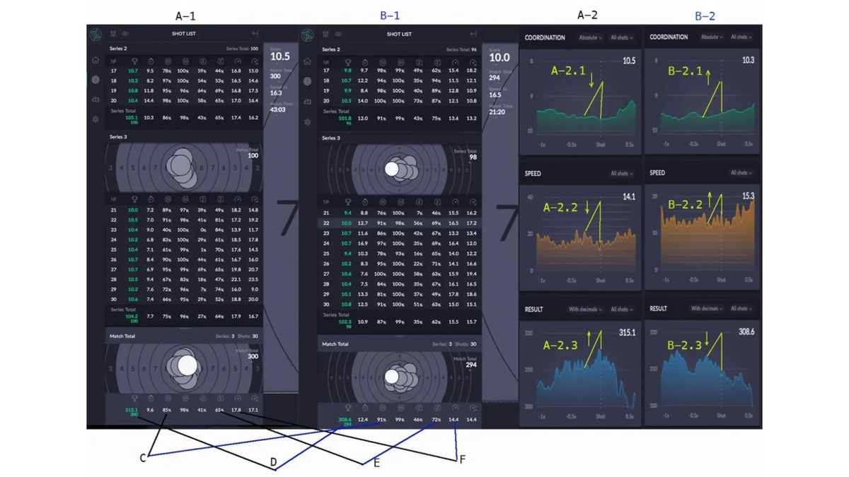

The composite below brings together the stability measures and results of the same air-rifle shooter. The SCATT files contain the same number of shots, recorded under identical conditions 11 days apart.
Example of the Paradox in the Relationship Between Shooting Results and Hold Stability
Comparison of two SCATT shooting sessions showing shooting results and hold stability measurements
Comparison of two SCATT sessions: one with a better result but poorer stability, and another with better stability but a poorer result.
The columns of SCATT screenshots are labelled A-1 and A-2 for the session with the better result but poorer stability, and B-1 and B-2 for the session with better stability but a poorer result. The latter session actually took place first.
The letters C, D, E and F, with arrows, identify the relevant figures. C shows movement amplitude as the percentage of the final second before the shot during which the aimpoint remained within the actual 10.0 zone. D shows the scores in whole points and tenths. E shows another important measure: stability relative to the size of the 10.5 zone. F shows the average speed of the aimpoint on the target.
The A-2 and B-2 columns contain graphs of the two sessions. A-2.1 and B-2.1 show the coordination curve over the last second before the shot and half a second afterward. The lower the curve, the closer the aimpoint is to the center of the target at that moment. A-2.2 and B-2.2 show aimpoint speed. A-2.3 and B-2.3 show the score that would correspond to the aimpoint's position at each moment.
All the graphs show averages for the 30 shots. The figures and curves show that, in one session, the shooter had better stability by every measure yet achieved a lower score. That is the paradox we are examining.
After the session with better stability but the poorer result, the athlete's errors were reviewed with him. In the next session, he concentrated less on stability and more on the subject of the rest of this article.
