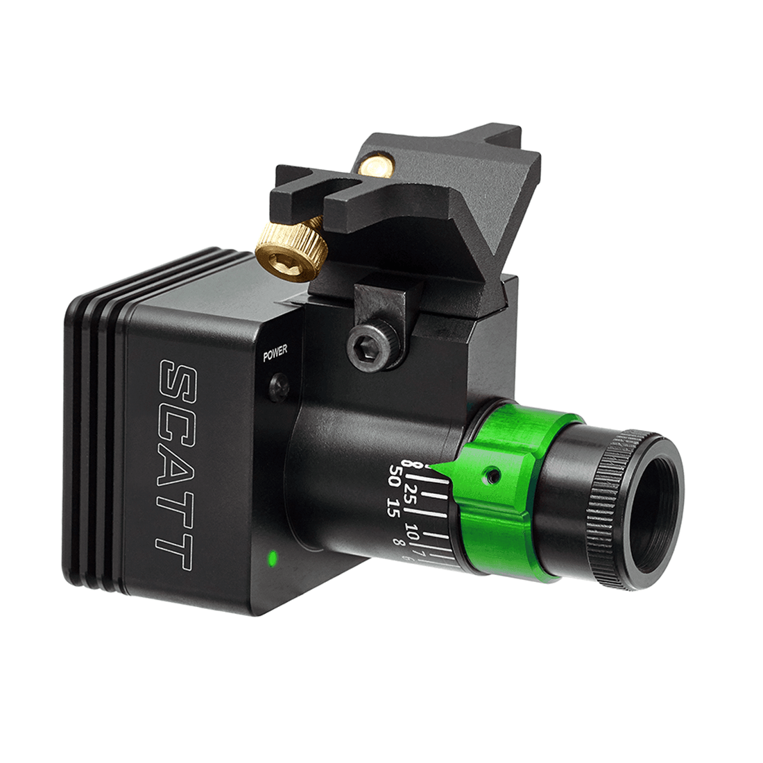

What really sets the MX-W2 apart is its fully wireless connectivity which works not only with laptops, but also with portable devices like Android or iOS smartphones and tablets. It can be connected to your computer or portable devices via Wi-Fi and its battery capacity delivers about 4 hours of practice time. If you forgot to charge your sensor before practice - no problem, the MX-W2 can work in wired mode, drawing power from your laptop or a power-bank while you practice.
This model can work with round black targets on white background, as well as police, biathlon, and archery targets.

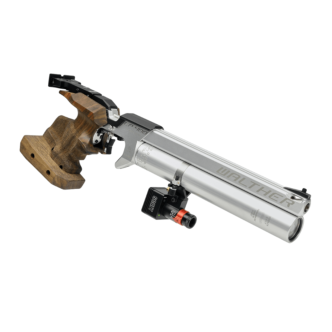

Unlike the older infrared SCATT models, the MX-W2 doesn’t require an electronic target downrange, all it needs is a well illuminated regular paper target. You can also use it at shooting ranges equipped with electronic scoring targets (like SIUS, Megalink, etc). The entire SCATT system is now concentrated in the optical sensor, so it's surprisingly compact. The MX-W2 optical sensor can be mounted on the vast majority of guns.

  • Optical sensor type – wireless / wired (Wi-Fi 2.4 Ghz, 20 Mhz Bandwidth / USB connection)
  • Optical sensor size: 34 x 35 x 60 mm
  • Optical sensor weight: 56 g
